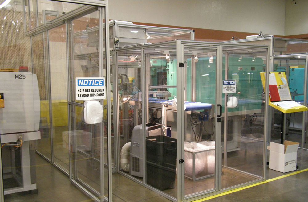

Clean rooms at Flambeau Medical are compact.

In a core strength, the company has a unique approach to clean-room molding, using what it calls "clean environment manufacturing cells."
Significant space reduction
"There's a lot of cubic feet of air in traditional clean rooms with high ceilings and overhead cranes," says Behm. "What if the clean room space is 10% of what it had been? You simplify the operation and take a lot of cost out."
In its novel approach, Flambeau encases the clamping unit of the machine so the part sees a Class 8 cleanroom. The machines are equipped with side-action robots. So as an example, for those parts made in the eight-cavity cassette tools, a side-action robot takes all eight parts at a time and puts them on an indexing conveyer. The parts are instantly annealed using a quartz technology. A monorail runs over the top of the machine to remove and insert tools.
The polycarbonate parts need to be annealed to remove stress cracking that could create problems if the parts were later exposed to solvents. Behm adapted the quartz annealing technology from the blow molding industry to avoid batch annealing in an oven. Using light rays from quartz, parts are annealed from the inside out.  "By annealing the parts right when they come out of the mold, no human hands need to be involved," says Behm.
Meanwhile, the machine is accessible to all personnel, who are not required to wear cleanroom garb. Chance of part contamination is reduced. A dozen class 8 clean cells are operating at the Arizona plant.
