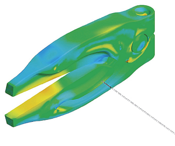

Through the EU-funded Innoclip project, a carbon-fiber-reinforced polymer aneurysm clip was developed. Image courtesy project partner Institut für Verbundwerkstoffe.
