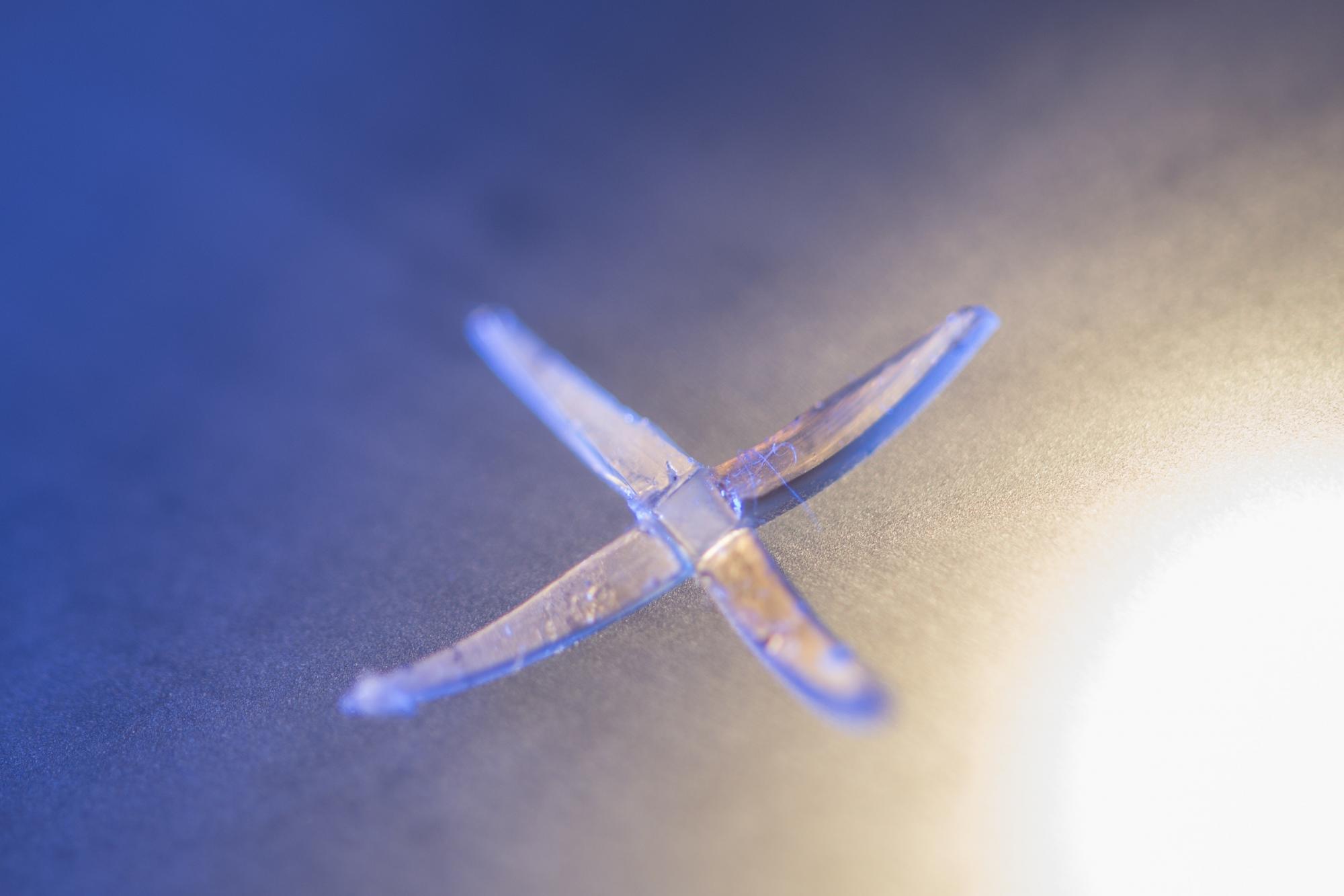

shape-shifting-polymer-300.jpgThe polystyrene layer that is bonded to the LCE is what enables the unique shape-shifting properties. Without it, the LCE would simply expand or contract along its nematic axis when heated. The stiffer PS layer produces a more elaborate choreography, causing the material to wrinkle, bend, or fold. A video shows the material in action.
Configurations are designed into the material by applying parameters such as the shape and aspect of the LCE, the thickness and patterning of the PS, and the temperature at which the PS is applied. Researchers say that there is no limit to the complexity of the shapes that can be teased from the material by playing with the patterning.
