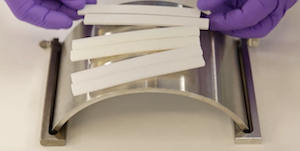

In a video (embedded below) demonstrating the test, Medical Application Development Scientist Yubiao Liu, PhD, who developed the protocol, subjects a number of materials, including Eastman’s own Tritan MXF121, PC/PBT, PC/polyester, PC/ABS 1, PC/ABS 2 and PVC to several commonly used disinfectants. The steps are as follows:
  1. Select a jig with the appropriate strain level.
  2. Load plastic flex bars onto the jig.
  3. Apply commonly used chemicals in hospitals such as disinfectants, lipids and drugs to the flex bars and enclose the jig and samples in a plastic bag to prevent evaporation.
  4. After 24 hours, remove the jig from the bag and unload the samples.
“You may already see changes in some of the plastics,” says Liu, “but don’t stop there. There might be crazing and cracking that is not visible to the naked eye.” He recommends running an impact test and recording the impact strength of the exposed and control samples.
