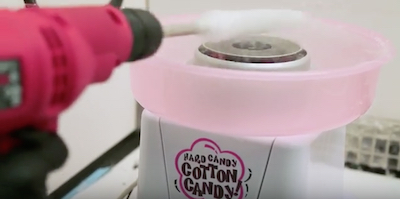

on Feb. 4, Bellan and his team of researchers reported that they were successful at producing a three-dimensional artificial capillary system that can keep living cells viable and functional for more than a week. And it all started with a $40 cotton-candy machine Bellan bought at Target.
cotton-candy-machineWhile attending a lecture on tissue engineering that discussed the need to create an artificial vascular system to support cells in thick engineered tissue, it occurred to Bellan, then a graduate student, that electrospinning can produce networks resembling capillaries on a very small scale.
"The analogies everyone uses to describe electrospun fibers are that they look like silly string, or Cheez Whiz, or cotton candy," Bellan told David Salisbury, who reported on the project for Research News @ Vanderbilt. "So I decided to give the cotton candy machine a try. I went to Target and bought [one] for about $40. It turned out that it formed threads that were about one-tenth the diameter of a human hair—roughly the same size as capillaries—so they could be used to make channel structures in other materials." Getting from there to the point of publishing a paper on the succesful application of that technology required considerable tinkering, of course, as well as finding a suitable material.
