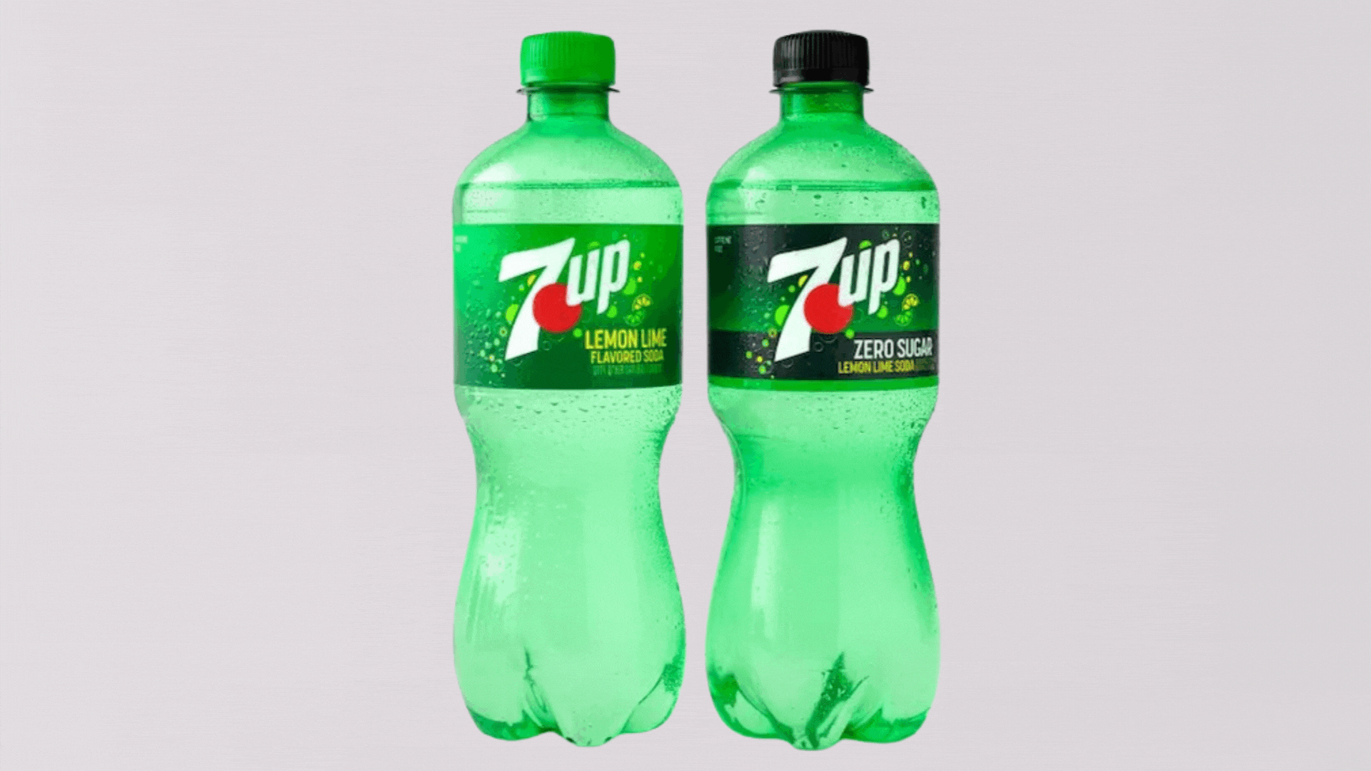

It’s got to be frustrating for the people who come up with packaging design guidelines for sustainability — only to have them ignored.
Case in point: 7UP recently modernized its graphics. As a regular 7UP drinker, I can say, I think the new “effervescent” design works. It’s clean and contemporary. I am happy to buy 7UP in the new packaging.
But …
We live in a world where sustainability and circularity rule. So why, oh, why, are the bottles still tinted green?!
When we asked, Allison Kapp, senior brand manager at Keurig Dr Pepper (KDP), answered, “The brand refresh is specific to 7UP’s visual graphics across the portfolio, and no changes were made to the primary packaging.” Then she added, “We work closely with the Association of Plastic Recyclers (APR) guidelines to design ‘APR preferred’ packaging that is fully compatible with plastics recycling systems, and our 7UP plastic bottles are recyclable.”
We don’t need no stinking guidelines.

To prove the point, the image above shows how 7UP’s new design would look if the bottles were clear PET instead of green. I think the branding still works. But … if you wanted more of a color-block on shelf, make the label 4 or 6 inches high instead of 2 (ish). But … then add a perforation so the labels could be easily removed by the consumer before the bottle and cap are put in the recycle bin.
