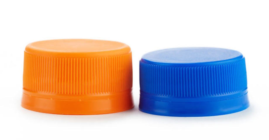

Short-neck caps save significantly on material usage.
