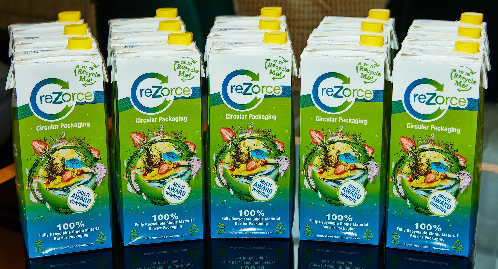

The ReZorce mono-material barrier packaging range.

A new 100% recyclable package is on track to give traditional beverage cartons a run for their money. The ReZorce beverage carton is a mono-material barrier package with a unique construction made for easy household recycling and sorting through standard streams in material recovery facilities not just once, but many times over.
ReZorce cartons consist of more than 95% HDPE, chosen for its recyclability in standard recycling streams, plus a bit of EVOH. Tethered caps applied to the cartons are also made from polyethylene so they can be recycled together with the carton.
Unique structure performs like paper.
But the technology that sets ReZorce apart hinges on a multi-layered polymer sheet material that feels and folds like paperboard and can be decorated with surface printing. The carton’s unique construction is created using a microcellular foaming technology owned and licensed by Zotefoams that injects atmospheric gases into plastic extrusions during the melt phase to create a foamed core bounded by solid skins.
Multiple internal layers can be created with different degrees of foaming, with the microcellular structure creating an inherent physical barrier to the passage of oxygen and moisture, explains Neil Court-Johnston, President, MuCell Extrusion LLC, which produces the microcellular foaming technology used in the manufacture of ReZorce. He adds that the material has been tested by recyclers Biffa and Veolia to confirm that it can be sorted through standard streams in material recovery facilities.
