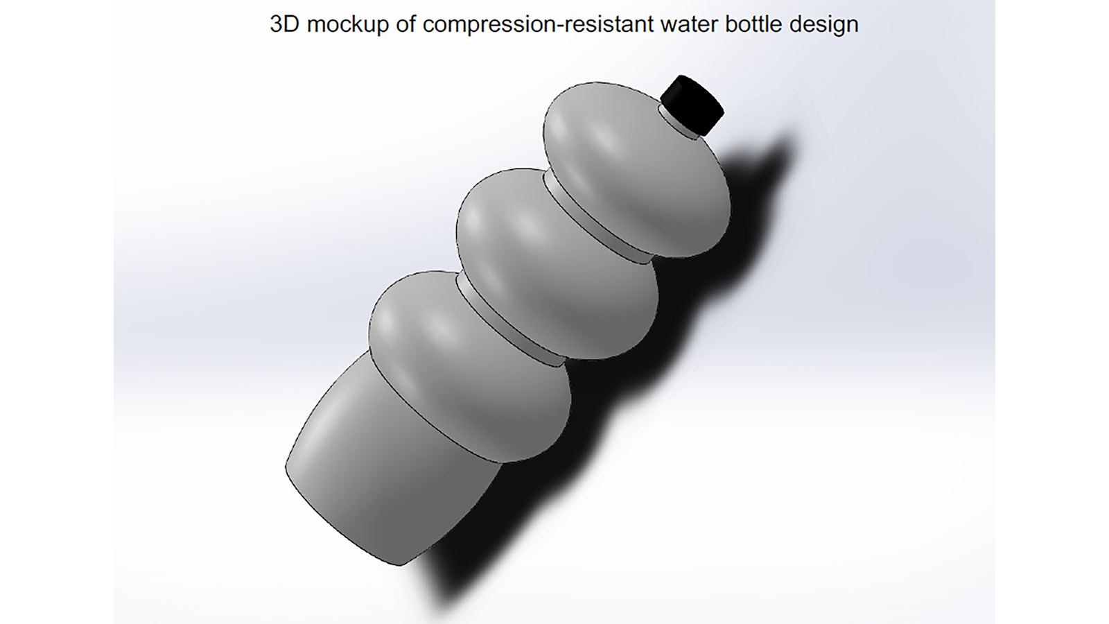

First-place honors in the 2024 challenge went to a reimagined PET beverage bottle dubbed the Strong Bottle, which features a novel geometry designed to boost recycling rates. The Strong Bottle team is based at Boise State University.

The Strong Bottle team, led by Boise State graduate student Terra Miller-Cassman, undergraduate Taylor Fackrell, and mechanical engineering professor Aaron Smith, proposed a clever solution to the common problem of lightweight, single-use water bottles being flattened during the recycling process and consequently being improperly sorted.
With current PET water bottle shapes, the pressurized air-sorting technology at materials recovery/recycling facilities (MRFs) can blow flattened bottles into the paper recycling stream rather than properly diverting them to go with bulky plastic items. The flattened bottles contaminate the collected paper, and the paper/bottle mixture ends up in landfill.
This type of paper-stream contamination occurs so frequently that many municipalities have eliminated lightweight PET water bottles from their curbside recycling programs.
Strong Bottle features a new disposable water bottle shape that won’t flatten during recycling and could create a 15% increase in the PET collected.
The new shape features alternating spheres and cylinders. As compression force presses on the spheres, the load is distributed, reducing total compression force on the sides of the bottle and preventing flattening.
“Our team developed Strong Bottle to increase the supply of recycled PET,” said Miller-Cassman in her presentation at the NPE2024 showcase. “We have essentially redesigned the water bottle to make it universally recyclable.
“If the major beverage brands were to adopt the Strong Bottle design, it would influence widespread acceptance of lightweight bottles in municipal curbside recycling programs, and this would increase the amount of recycled PET by 400 million pounds per year for a total amount of 1.2 billion pounds per year in recycled PET bottles,” she added. “This is a 60% increase over the amount of recycled PET bottles that were captured in 2022.”
Strong Bottle uses the same amount (6 grams) of PET as an ultra-light-weight water bottle.
The Strong Bottle was developed as a drop-in solution for existing PET water bottles and designed to be manufactured using existing bottle-manufacturing methods.
Following the developmental stage, the Strong Bottle team plans to “manufacture a prototype by blowmolding the shape and gather feedback from customers in the beverage industry and run a pilot test with a material recovery facility,” Miller-Cassman said.
Although initial renderings show a grey bottle, the Strong Bottle prototype will be molded from clear PET.
