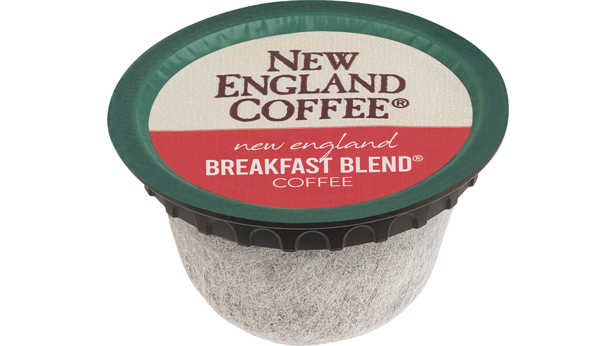

The company announced it is replacing all its plastic single-serve coffee capsules with an eco-friendly capsule from PurPod. The PurPod100 capsule features a bio-based mesh filter, and the capsules can be commercially composted, with no need for disassembly.
The capsule, which works with Keurig K-Cup-style brewers, meets the rigors of capsule brewing while delivering a tastier cuppa than conventional capsules.
Three bio-based materials are used to construct the PurPod100 capsules. The lidding is a cellulose film, and the mesh filter is made from a novel, thermoformable polylactic acid (PLA)-based material sourced with plant materials.
The capsule’s brown ring is made from a proprietary resin created using coffee bean skins, aka chaff, and other compostable materials. Chaff is a by-product of coffee-bean roasting. The ring is designed to withstand the brewing process without compromising the quality of the coffee.
