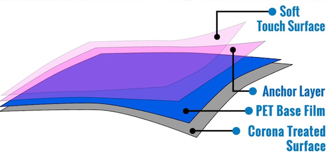

FlexFilms (Elizabethtown, KY) has developed a polymer film with a satin-soft surface that is also strong and durable. The bi-axially oriented polyethylene terephthalate (BOPET) film, FLEXPET F-STF, reportedly exhibits exceptional scratch, heat and scuff resistance. The durable surface self heals most scuff marks.
“If we scratch the surface of this film, it won’t [stay] scratched,” said Dr. Steven J. Sargeant, General Manager, Technology. “Soft touch is rendered through a robust surface coating in combination with a proprietary in-line anchor coating on the base polyester film. This combination imparts unique properties of self-healing, toughness and durability along with the soft texture. This effectively increases converters’ yields, as they generate less scrap and have fewer customer rejections or other associated issues.”
