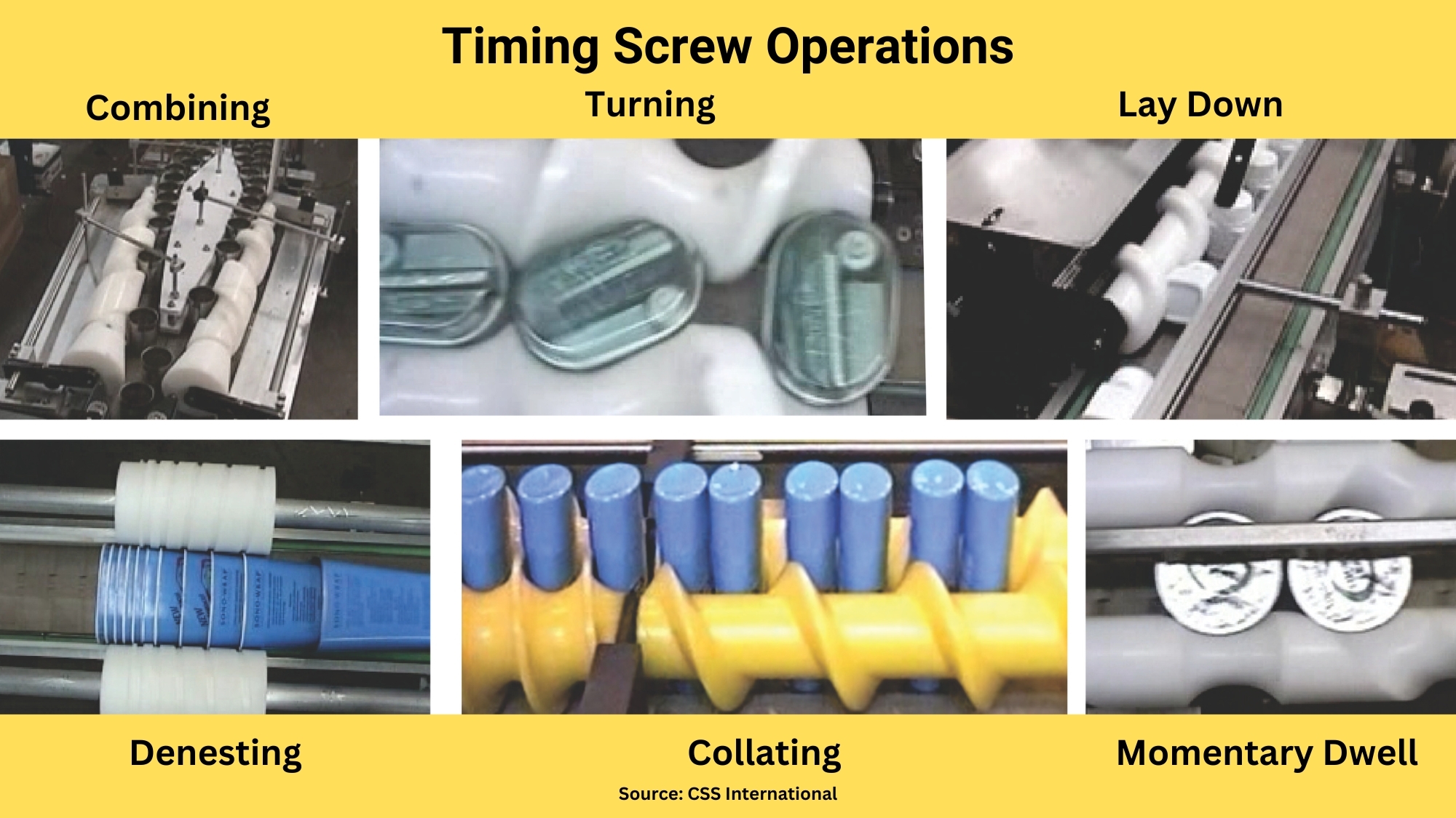

We are all familiar with screws for fastening and adjusting. Timing screws are a special kind of screw that have many uses in packaging. They are commonly used to time or synchronize products or packages into packaging machines in the correct position and orientation for whatever operation is to be performed on them.
Instead of narrow uniformly pitched threads, timing screw threads are cut to fit the shape of the product. Another difference is that the space between threads or “pitch” is commonly not uniform from screw infeed to discharge.
One common application is timing bottles into a starwheel on a filler. The bottles typically are bunched up entering the machine. When they reach the screw, the leading thread picks off the first bottle. As the screw rotates and the pitch increases, the bottles are separated to the desired spacing as seen in the simple screw below.
If the bottles are to be timed into an infeed starwheel, the screw and starwheel are linked mechanically or electronically. The final thread releases the bottle directly into the starwheel pocket as seen below:
In addition to spacing and synchronizing, timing screws have many applications (see image at top). They can turn, combine, position, flip or pause bottles, jars, cans, tubes, pens, broccoli, and pretty much anything else.
