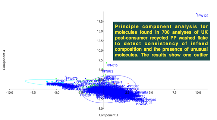

PP flake studies: 700 analyses from 17,500+ different pieces of packaging.
NextLooPP experts ran 700 headspace analyses by GC-MS — an analytical method that combines the features of gas-chromatography and mass spectrometry — to identify different substances within test samples taken from post-consumer washed PP flakes. These PP flakes were taken from over 17,500 different pieces of packaging and the large data set was screened through the statistical approach, Principal Component Analysis, on the chemometric data to identify outliers, along with comparing each peak found against the NIST mass spectral library.
