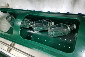

Pretium Packaging (Chesterfield, MO), which recently launched the SureHandle polyethylene terephthalate (PET) container with an integrated handle (see Pretium commercializes PET container with integrated handle, published August 2017), has received validation that it can be used for high-pressure processing (HPP) food and beverage applications.
Because HPP does not rely on heat for pasteurization, this validation opens the door for products that are using this relatively new cold processing pasteurization to go to market in an equally new, disruptive container which will protect the products' nutritional and flavor profile. An additional benefit is that HPP enables the use of less expensive, linerless plug-seal style closures.
HPP testing was facilitated by The Packaging School at the Rochester Institute of Technology. The SureHandle bottle was also subjected to compression, drop and tensile testing to ensure it would meet the rigorous distribution demands.
