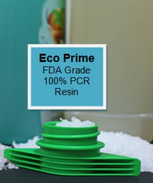

Companies are pushing sustainable packaging forward on all fronts including for the components used on primary packaging such as pouches. One of those is pouch fitment/weld spout manufacturer HQC Inc. (Oswego, IL), which has been testing two 100% recycled materials for moldability and inserting compatibility, one an industrial grade and the other the EcoPrime resin from Envision Plastics (Reidsville, NC).
The EcoPrime resin earned a Letter of No Objection from the U.S. Food and Drug Administration, allowing its use for food packaging. EcoPrime is a safe post-consumer high-density polyethylene (HDPE) resin that does not contain BPA, phthalates, heavy metals or allergens, emits 78% less greenhouse gases than virgin resins and eliminates the need for colorants.
In producing sustainable pouch fitments/weld spouts, HQC has been experimenting with 100% EcoPrime resin and at different ratios of EcoPrime resin to virgin resin. Results have been highly positive. Enhancements to both the molding process and seal bars have allowed the EcoPrime resin to rival certain 100% virgin petroleum-based materials.
