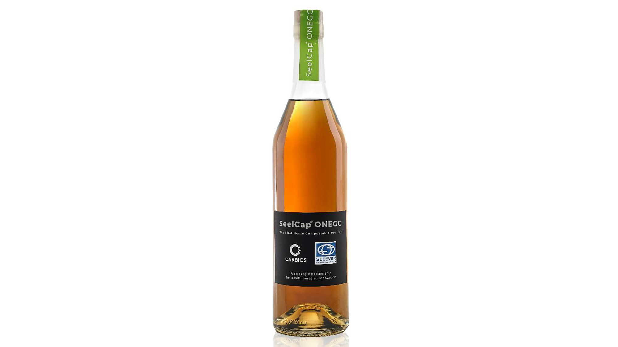

It seems to be a short jump from making a shrink-sleeve label home compostable to introducing additional packaging options from the same compostable technology platform. After reporting on a polylactic acid shrink-sleeve label several weeks ago, Carbios and Sleever leverage their combined know-how to introduce SeelCap Onego, the world's first home-compostable tamper-evident TE seal.
As with the PLA label, the compostable TE band relies on Carbios Active, an encapsulated enzyme that speeds the composting process.
Just how fast? It’s claimed that the new seal will completely degrade in composting conditions in less than six months even at room temperature per TÜV Austria “OK Compost Home” certification. This reduces the carbon footprint by up to 70%.
To add additional value, the proprietary design of the TE seal was developed by Fabrice Peltier with one additional goal beyond tamper evidence: enable easy opening in a single movement with a gripping flap.
The compostable seal is particularly suited for glass packaged products, especially those sealed with wooden caps that include bottled wines, spirits, and alcohol products.
It also solves a problem for recyclers. Due to the small size of this type of TE band (less than 60 mm or 2.5 inches), conventional plastic TE seals do not work with traditional packaging sorting and recycling flows, according to the supplier.
