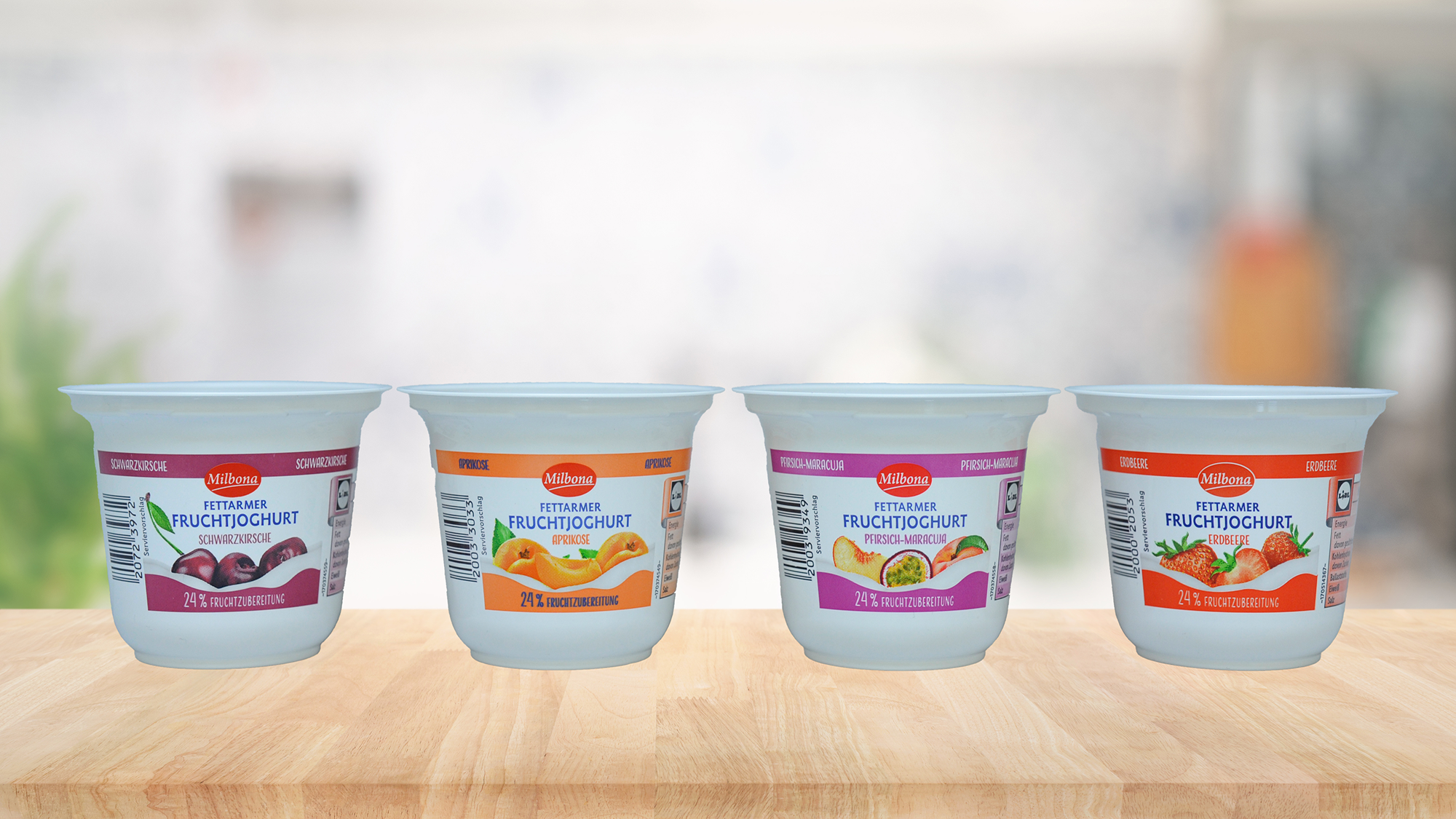

Plastics circularity has taken a step forward with the launch of the first yogurt cup made from mechanically recycled polystyrene (PS). The yogurt, marketed under the Milbona brand, will roll out at Lidl supermarkets in Europe early 2025.

To make the recycled PS used to thermoform the cups, Ineos uses a mechanical recycling process that starts with deep near infrared (NIR) sorting.
PS recycling achieves 99.9% purity.
NIR is used to separate rigid PS from foam PS. The rigid PS, from used PS yogurt cups, is ground into flakes and then hot washed. The flakes are rinsed, dried, sorted, and then “super cleaned.”
In this last step, the flakes are melted at a high temperature and then exposed to vacuum technology to remove any lingering impurities. The final pelletized recyclate is 99.9% pure and safe for food contact. Previously, only PET bottle recyclates had achieved this level of circularity.
Ineos Styrolution’s super-clean process is registered as a novel technology under European Union (EU) regulation 2022/1616 on recycled plastics intended for food contact.
The recycled PS exhibits the same physical properties as virgin PS and behaves the same during extrusion and thermoforming — but has a much smaller environmental footprint than virgin polymer.
