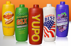

New from Yupo (Chesapeake, VA), a global supplier of in-mold label (IML) film substrates for consumer blowmolded packaging, is Sculpt IML patented technology, which the company showcased at the recent IMLCON/IMDCON in Chicago. The decorative embossed surfaces will give brand owners a “stronger presence on the shelf and in the mind of the consumer,” said Yupo. The embossed surfaces create a distinctive visual and tactile appearance that entices consumers to look at and touch the products.
The molds (or inserts) are machined in the portion of the IML area to produce a “raised” effect, so that when the label is applied through the IML process it imparts a unique look and feel to the bottle or container. This allows brand owners to market a number of visual and tactile enhancements on the package by playing with graphics and structural dimensionality, said Yupo.
Additionally, the new Yupo Sculpt IML technology provides seamless labels that are less susceptible to counterfeiting, thus protecting the products and brand reputation. Compared with pressure-sensitive labels, Yupo Sculpt IML technology substrates have no adhesives or release liners, so waste is dramatically reduced during the manufacturing process.
Yupo Sculpt IML technology also enhances a brand’s visual impact, because of the extra dimension granted to product pictures and graphics.
