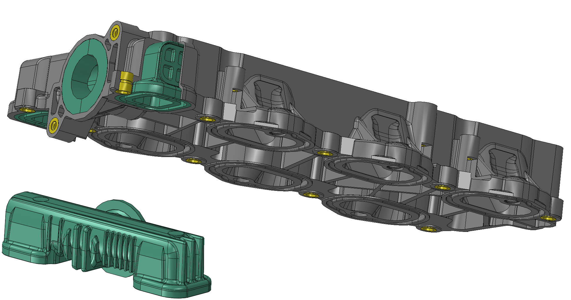

The new Ford 3.5L and 3.7L engine manifold uses a cross-over coolant component made of DuPont Zytel HTN PPA resin instead of brazed metal, shaving one pound to improve fuel economy.
