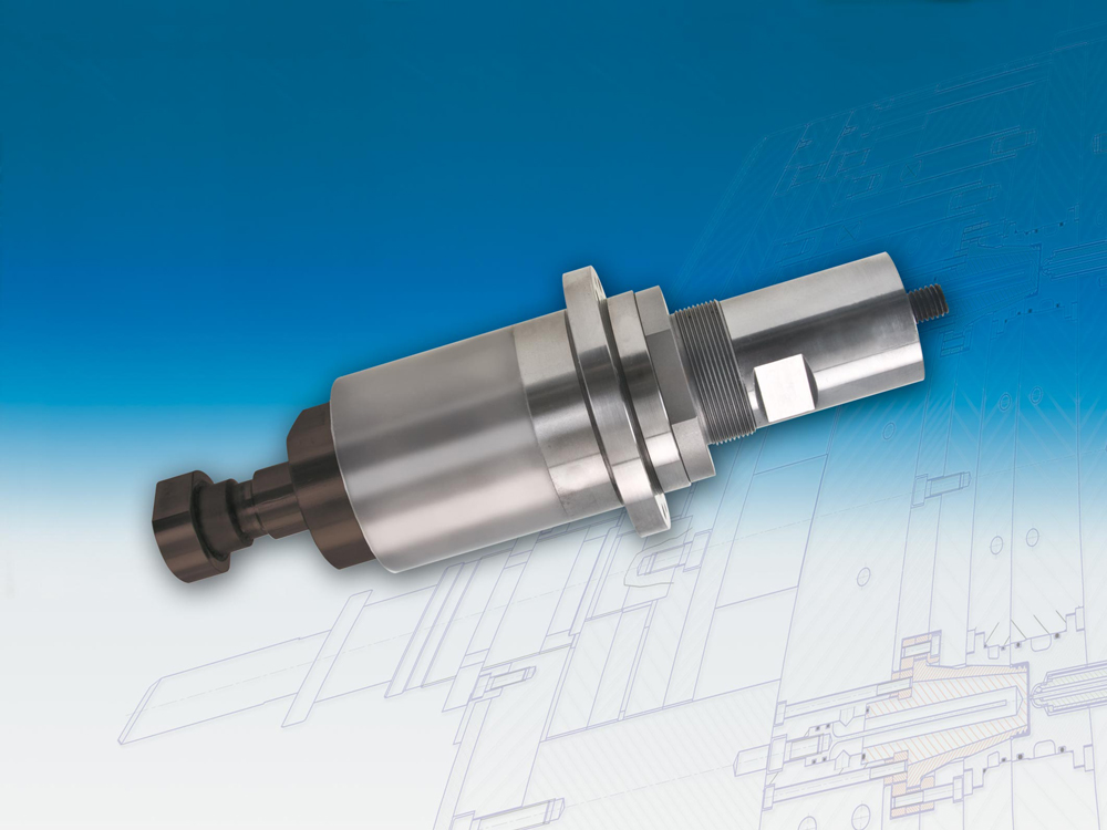

Another technology used in two-stage ejection is in molds that incorporate a stripper plate, or for the separate demolding of the sprue and part. For that, Hasco supplies the Z1692 to implement special series sequences, such as those required for underground slides or inclined sliding carriage elements.
These advanced two-stage ejectors, which are designed for central installation, make it possible to define the two strokes that are required independently of each other. This independence is achieved because the stroke of the three standard sizes, with maximum stroke lengths of up to 180 mm, can be adjusted by means of a simple modification.
Z1692-DLC-300_0.jpgHasco also supplies the two-stage ejector Z16291 as a special, customized version with pre-set strokes.
The functional surfaces of all Hasco two-state ejectors have a diamond-like carbon (DLC) coating to allow these products to be used in cleanrooms and for the production of parts for medical device and food industry components. With its hardness and slip properties, the DLC layer helps to avoid abrasive and adhesive wear. By eliminating lubricants, maintenance costs and downtime are reduced, said Hasco.
