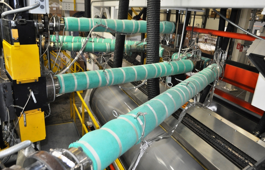

Melt pipes at Paragon Films Inc. (Broken Arrow, OK) use SmartHeat technology to ensure uniform temperature control.
