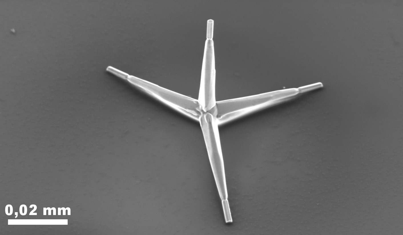

Tetrapod shape aids bonding (CAU, Xin Jin)

The key to the approach is the use of very tiny crystals made of zinc oxide that are shaped like tetrapods with four legs protruding from the point of origin. They interlock and form strong bonds, and have been used in larger forms in coastal protection.
Here's how it works:  zinc oxide crystals are distributed carefully on a heated layer of PTFE, kind of like sprinkling sugar on partially baked cookies. After silicone is poured on top, the polymer sandwich is heated to 100°C for less than sixty minutes.
"It's like stapling two non-sticky materials from the inside with the crystals: When they are heated up, the nano tetrapods in between the polymer layers pierce the materials, sink into them, and get anchored", says Xin Jin, the first author of the publication, who is currently working on her PhD thesis. Her supervisor, Yogendra Kumar Mishra, adds: "If you try to pull out a tetrapod on one arm from a polymer layer, the shape of the tetrapod will simply cause three arms to dig in deeper and to hold on even firmer."
