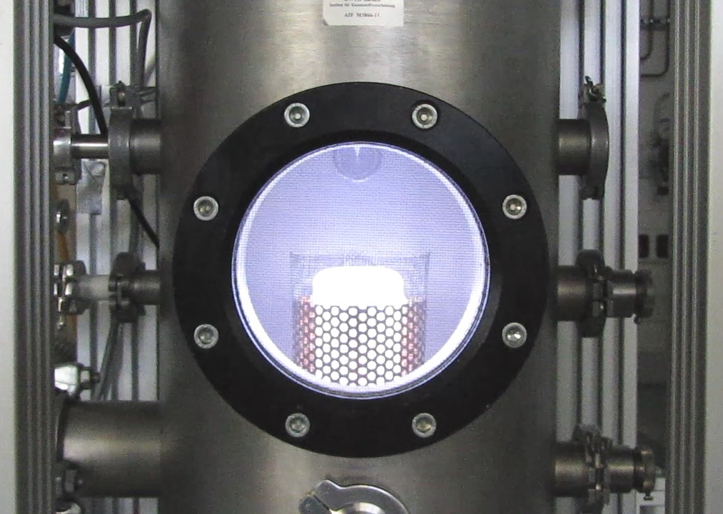

A plasma reactor in the IKV's lab helps the researchers there vary the level of substrate-bias on a film or bottle.

The current investigation is focused on a process to enhance the barrier performance of plasma-polymer layers by the use of a substrate-bias. Studies on films have shown that the deposition of barrier coatings using a substrate bias leads to a significant increase in the barrier properties because the negative effect of layer defects is reduced. The IKV has built a plasma reactor so that it can bias the inserted PET bottle and study the results. After a successful validation of the process a transfer ofthe technology to other materials such as polylactic acid (PLA) is planned.
