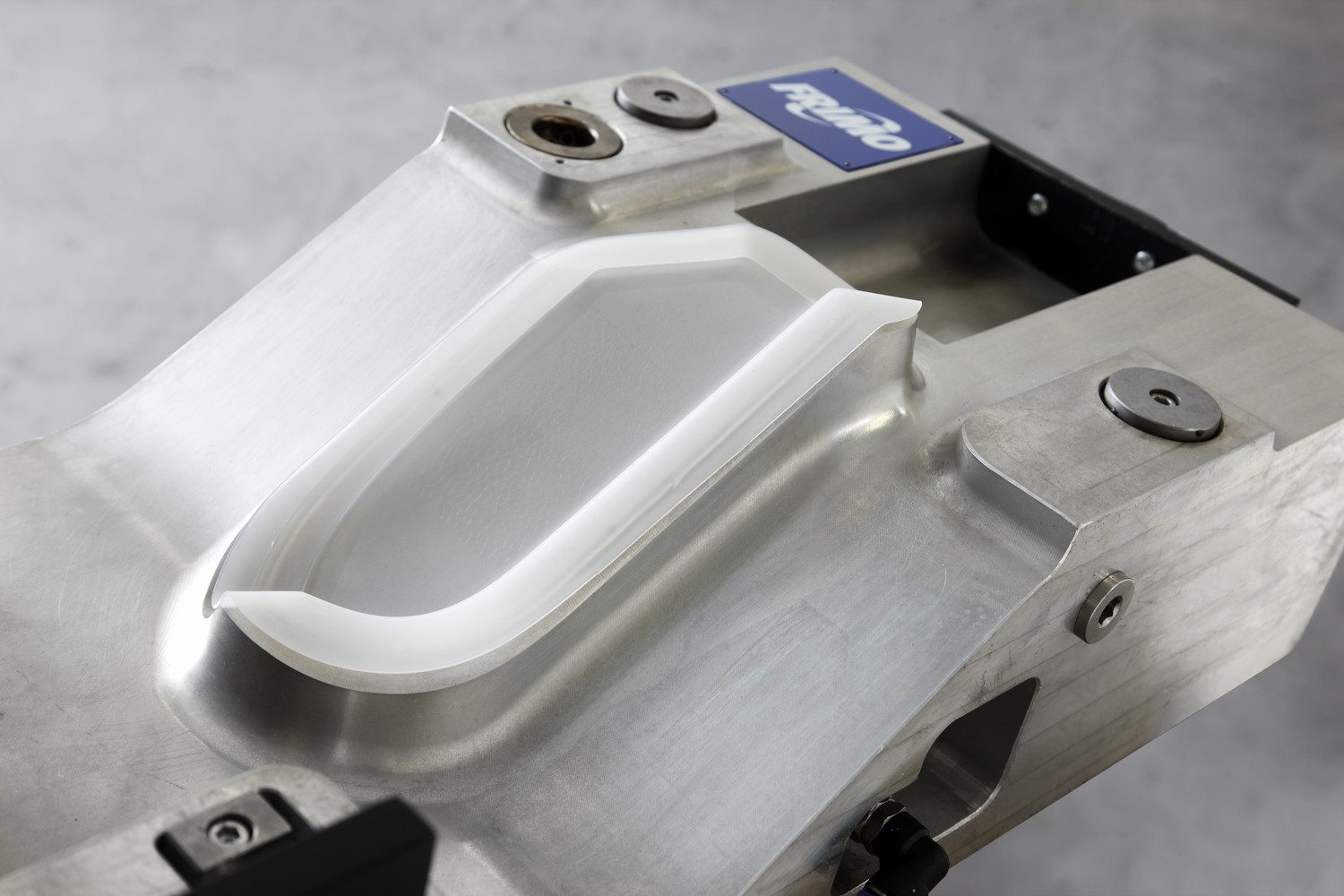

The PURe Liner from Frimo (Wixom, MI)  is a semi-permanent mold liner made of a self-releasing plastic compound. Patented by a German partner company, this process has been further developed by Frimo with regard to the front-foaming (partial back-foaming of inserted substrates) of polyurethanes. Due to its unique material composition, the innovative PURe Liner permits low demolding forces while remaining in the mold cavity.
The PURe Liner is fitted over the complete surface of the mold and is held in place via vacuum. It can be easily replaced within 15 seconds. The use of PURe Liner not only eliminates the need for a release agent station:  it can also reduce cycle times, cut labor costs, eliminate the need for added molds, reduce scrap and save additional investment costs. In addition, the PURe Liner allows for surface textures to be applied directly in the injection molded liner process, which is then transferred to the polyurethane molded article.
The PURe Liner is most often used when processing interior automotive components such as arm rests but Frimo is actively looking at opportunities to use the innovation in other applications to help produce much larger parts.
Frimo offers its customers individual PURe Liner concept analysis and cost benefit calculations on a project-by-project basis depending upon the required parameters. Results from projects in production show cost savings of up to 20 percent over a program life versus the conventional processes that use a release agent.
