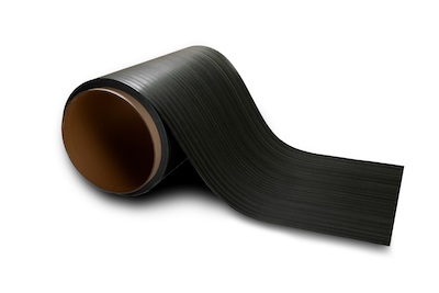

Japan’s Teijin Limited has developed the country’s first prepreg, or carbon fiber sheet, pre-impregnated with bismaleimide (BMI) matrix resin that offers high resistance to both heat and impact, thereby making it ideally suited to use in aerospace engine components.
March 4, 2019
Teijin develops heat-, impact-resistant prepreg for aerospace applications
Teijin’s new BMI resin pre-impregnated prepreg achieves a high glass transition temperature (Tg) of 280°C and compression after impact (CAI) of 220 MPa.
Teijin’s new BMI resin pre-impregnated prepreg achieves a high glass transition temperature (Tg) of 280°C and compression after impact (CAI) of 220 MPa, which is said to be a previously difficult combination realized by Teijin’s proprietary resin-composition formulating technology. The new prepreg also reportedly maintains its coefficient of linear thermal expansion and high dimensional stability at both low and high temperatures. Moreover, by adjusting resin viscosity, Teijin has also improved moldability by adjusting the resin flow through preforms in the mold cavity and reduced curing time with its new prepreg compared to conventional BMI-based prepregs.
Prepregs are generally impregnated with lightweight, high-intensity epoxy resin. Conventional BMI resin-impregnated prepreg is already used for high-temperature applications such as aerospace engine components to prevent degradation and deformation, however, it normally loses its impact resistance when heat resistance is increased. Also, CFRP made of BMI resin tends to peel apart and crack when subjected to strong impacts. In addition, molding BMI resin can be difficult due to its liquidity.
