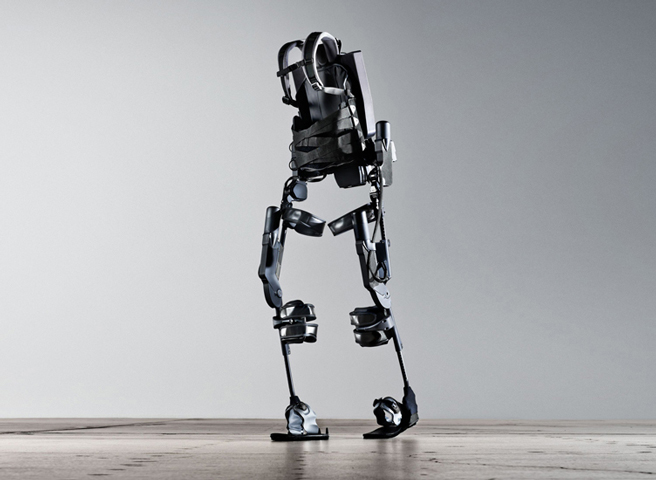

The exoskeleton is mainly constructed from aluminum and weighs approximately 50 lb, which the user does not support as the exoskeleton is engineered so that the weight is transferred into the ground. Plastics also play a role in the suit design (and their use may increase as demand ramps up).
"The volumes are low at this point—in the hundreds—so we don't have the economy of scale where we can go to injection molding yet," says Angold. "But we do use injection molded plastic parts for some of the complex shapes, such as the handles. And we have taken advantage of the low thermal conductivity of plastics to insulate the motors. We can run them hotter without affecting user comfort," says Angold. Materials used in the construction of the exoskeleton include nylons, ABS, and composites.
In collaboration with 3D Systems, Ekso recently presented the first 3D-printed hybrid exoskeleton robotic suit. The users body was scanned to enable a custom fit for the suit that conformed to the shape of her legs and back, as reported in MPMN. Ekso uses 3D printing technology for some low-volume production, but it's especially useful in the iterative design process, says Angold.
