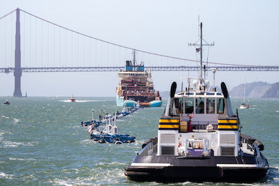

The system was towed out of San Francisco Bay on September 8 by the Maersk Launcher
System 001 consists of a 600-meter-long (2000-ft) U-shaped floating barrier with a three-meter (10 ft) skirt attached below. It was fabricated from 12-metre sections of extruded HDPE joined together at a shipyard near Oakland and incorporates a three-meter deep “skirt” made of polyester resin that dangles beneath the boom to prevent litter from escaping under it. Buoyant plastic tends to float within a metre of the water’s surface and are captured by the skirt.
