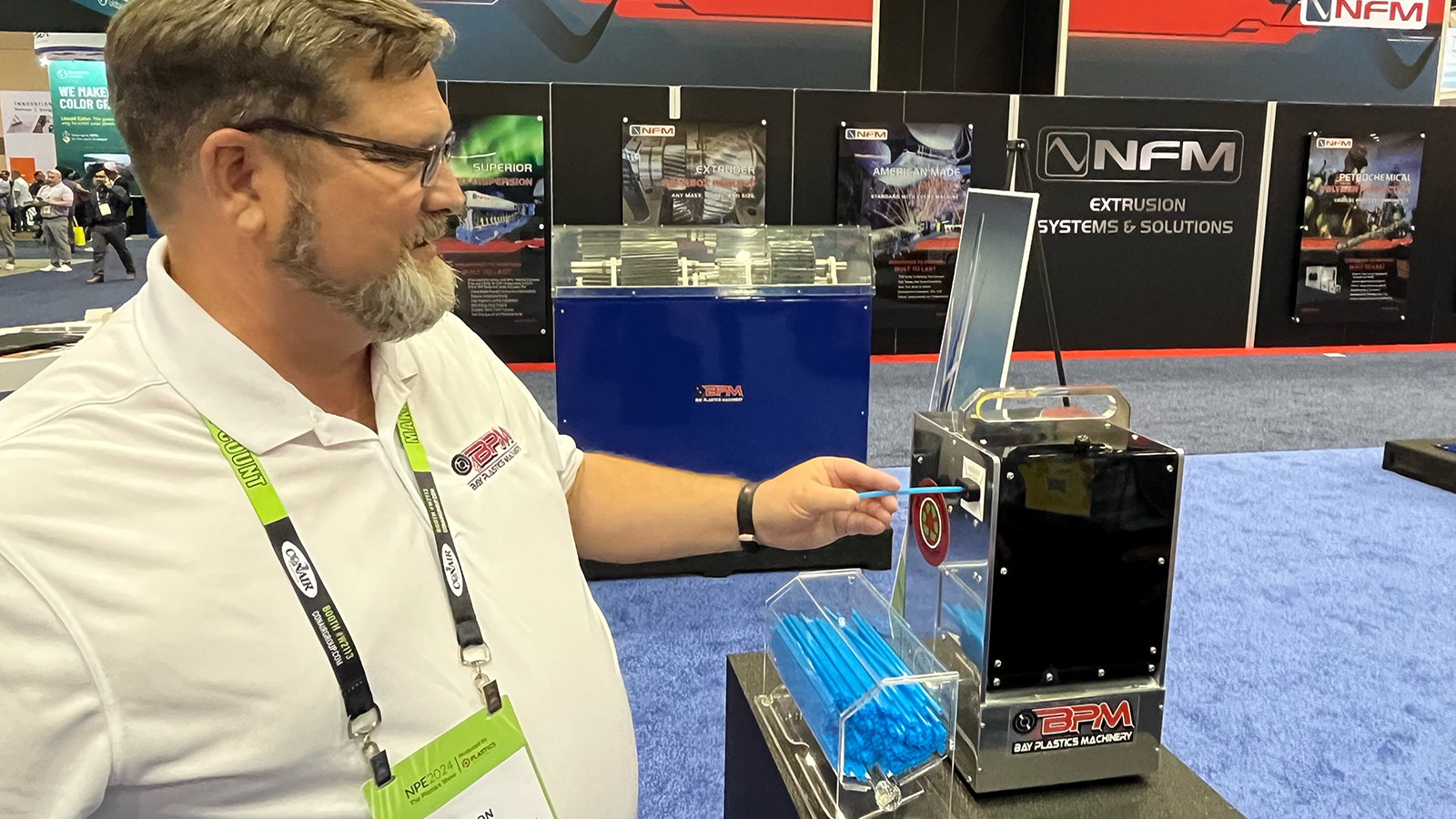

Jason Forgash, Bay Plastics Machinery CEO, and the Straw Cutter
Image: Geoff Giordano
Amid much ado about plastic straws, Jason Forgash of Michigan’s Bay Plastics Machinery is thinking inside the box — namely, the BPM Straw Cutter, a countertop unit that ingests the pesky little pipes, shreds them, and bags the remnants for recycling.
Forgash, BPM CEO and president, began thinking of the project a few years ago before handing his concept over to BPM’s engineers to make it a reality. After three iterations, the Straw Cutter was born and ready for its debut at NPE2024.
New pellets from old straws.
Making straws greener is simple with this unit: Just feed a single straw through the inlet, and a small cutting unit inside cuts the polypropylene straw into pieces that fall into a mesh polypropylene bag. When the bag is full, users can ship it to BPM’s recycling partner via Fed-Ex, where it will be turned into new pellets.
Shared DNA with strand pelletizer.
The device features a simple cutting unit with a rotary blade, upper and lower feed roll, and bed knife — essentially a mini strand pelletizer. The cutter attaches magnetically inside the unit; if it breaks, customers can send it back to BPM for repair.
