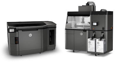

HP's Multi Jet Fusion 3-D printing system.
