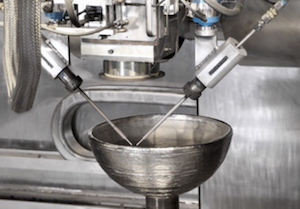

Sciaky Inc. (Chicago), a subsidiary of Phillips Service Industries Inc. (PSI) and a provider of metal 3D printing technology, announced last week that its Electron Beam Additive Manufacturing (EBAM) technology helped a major automotive manufacturer cut significant time and cost with the creation and repair of several tooling and stamping dies. The un-named manufacturer leveraged Sciaky’s EBAM to deposit complicated tooling features, as well as perform customized repairs and cladding operations for several high-volume parts. After a successful proof of concept, the 3D printed tool was put into production.
Metal 3D printing’s capabilities have expanded exponentially through the development of materials. For example, Sciaky offers a wide range of metals, including titanium and titanium alloys, Inconel 718 and 625, tantalum, tungsten, stainless steel (300 series), and 2319 and 4043 aluminum, among others. The company also claims that the EBAM system is the fastest and most cost-effective 3D printing process on the market for large-scale metal parts.
The EBAM system can produce parts ranging from 8 inches to 19 feet in length, depending on the application, making it the most “widely scalable” work envelope in the market, the company noted.
