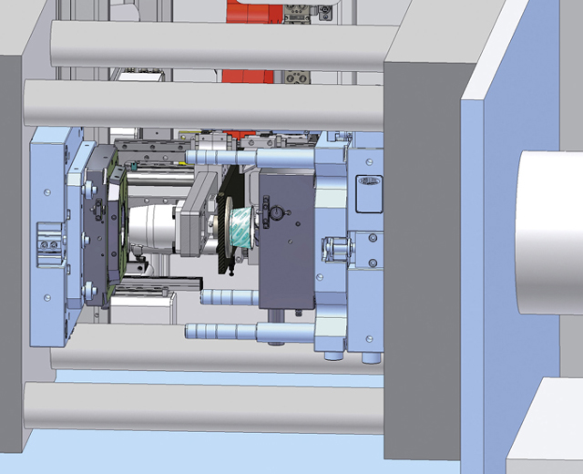

The multifunctional mold design by Müller allows easy installation. |
The IML robot shown at Fakuma features end-of-arm tooling that rotates 180 degrees and inserts labels in the moving or fixed halves of the mold. The molded parts are simultaneously removed and verified via a vision system before being stacked. The robot can be designed in single and two-cavity configurations, making it suitable for use during testing as well as small batch production.
