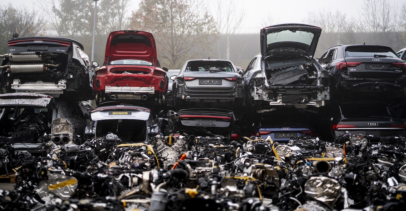

Back in October 2022, 100 vehicles, including former development cars, were dismantled as part of the joint MaterialLoop project. The targeted disassembly of individual components alone enabled the retention of high-quality secondary materials, such as larger plastic components, for recycling. After disassembly, the remaining car bodies were shredded and sorted into material groups comprising steel, aluminum, plastic, and glass. With the aim of testing the reuse of such materials in the production of new cars, Audi defined and piloted the recycling process together with project partners from the recycling industry, the Audi supply chain, and academia.
