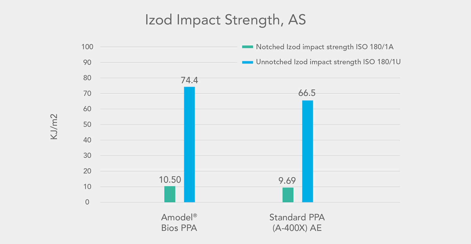

In addition, the limited moisture absorption of the new polymer versus standard PPA delivers a high level of dimensional stability at a low risk of stress corrosion, which is particularly important with regard to miniaturized electrical connectors. Amodel Bios PPA also provides good impact strength, even in halogen-free flame-retardant grades complying with UL94 V0, and is suited for colorable applications. This is complemented by high elongation, weld-line strength, and surface aesthetics.
