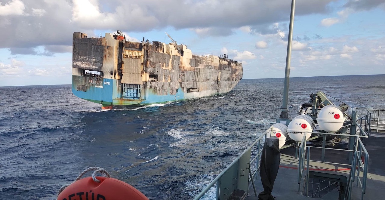

The recent fire and sinking of the Felicity Ace car carrier off the shore of Portugal with 3,965 Volkswagen, Porsche, Audi, and Lamborghini US-bound vehicles on board brought the potential hazards of electric vehicle (EV) batteries into the spotlight. Some industry stakeholders believe it is high time to develop standards that specifically address fire hazards in EVs. Bear in mind, though, that gasoline-powered vehicles, which commonly store gas in a polyethylene tank, are reportedly 60 times more likely to catch fire than EVs, but when you combine gasoline and electric in a hybrid car, the risk factor is multiplied 200-fold versus EVs.
