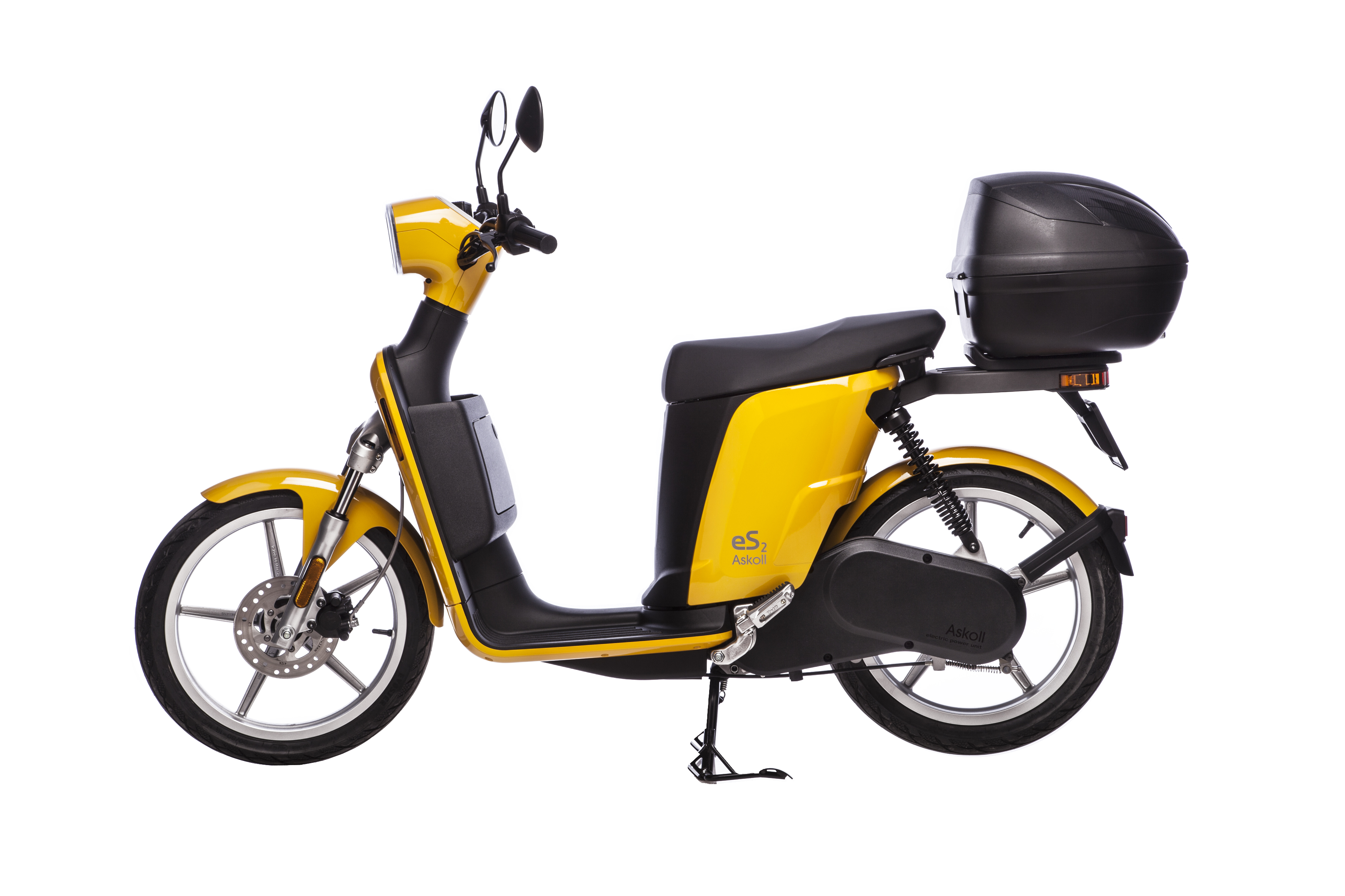

Made-in-Italy electric scooter uses low-warp, flame-retardant PBT/ASA blend in battery housing components.

Askoll uses the material for the battery cell housing of its electric scooters. It replaces a material solution based on a polycarbonate/ABS blend. “Our material was selected not only due to its low tendency to warp and excellent flame-retardant properties, but also because it meets the strict requirements relating to chemical resistance, thermal stability and impact strength. It also supports a safe ultrasonic welding process,” explains Fabio Passeri, HPM’s Sales Manager for Italy/Switzerland.
The white and black compound colors used to make the battery housings and frames for the two electric bikes were developed for Askoll. The compound replaces a glass fiber-reinforced, flame-retardant PBT with a UL 94 V-0 classification. The blend material from Lanxess scored highly with its excellent resistance to light and moisture, which ensures it passes the relevant weathering tests based on the conditions of ISO 4892-3.
“The high color stability means there is no need for the components to have a separate UV protective coating, which delivers significant cost savings,” reveals Passeri. The excellent resistance to weathering also ensures that the blend’s exceptional mechanical properties withstand very long periods of exposure to light and moisture. This is confirmed by tests on the finished component based on various standards for the safety of batteries, accumulators and electric bikes such as UN 38.3, IEC 62133 and UNI EN 15194.
