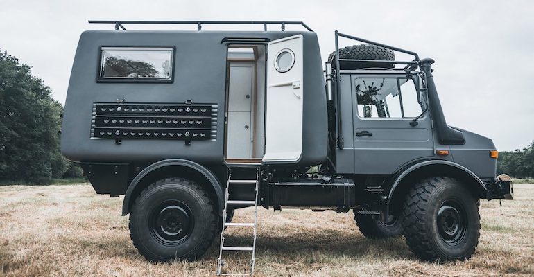

A cork map of the continents hangs in the cabin of the expedition vehicle made by Polygon Shelter, a startup company based in Magdeburg, Germany. This world map is a clear indication of who the small manufacturer builds their unique vehicles for: people who want to go out and explore the world in their own vehicle, who want to drive along what you would be hard-pushed to call tracks and take on hills that would prove too much for other all-wheel drives. “Our expedition vehicle is lightweight, compact, robust and suitable for mountainous, off-road terrain. What’s more, it offers the comfort of home on the road,” says Sascha Reiche, one of the founders of Polygon Shelter.
Reiche founded the vehicle manufacturing company in the state of Saxony-Anhalt together with his friend Mathias Herms and wife Catharina Reiche in 2019. Polygon Shelter manufactures its lightweight and functional expedition vehicles on the basis of the Mercedes Benz Unimog carrier truck. Its vehicles can drive anywhere where others would have to turn back. The lightweight design of the cabin plays an important role in that. “Instead of a traditional square box, we manufacture our cabins in an organic, polygonal shape modeled on the structure of honeycomb. The cabin is built as a one-piece fiberglass composite sandwich with a special surface coating. Campers are normally built using sandwich panels with plastic or aluminum angle sections. The lightweight vehicle cabin is compact and functional. It is from one cast and in a monocoque structure, achieving maximum stability and low weight at the same time,” explains company founder Mathias Herms. The optimized expedition vehicle from Saxony-Anhalt has a curb weight of 5.5 metric tons. With a full 400-liter fuel tank, 300 liters of fresh water and a typical load, it weighs 6.5 metric tons. Comparable vehicles made by competitors are often significantly above 7.5 metric tons.
