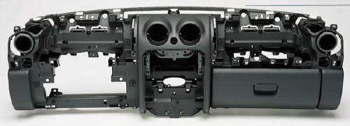

Instrument panels are among the applications that the new 85% LGF PP concentrate is targeting.
