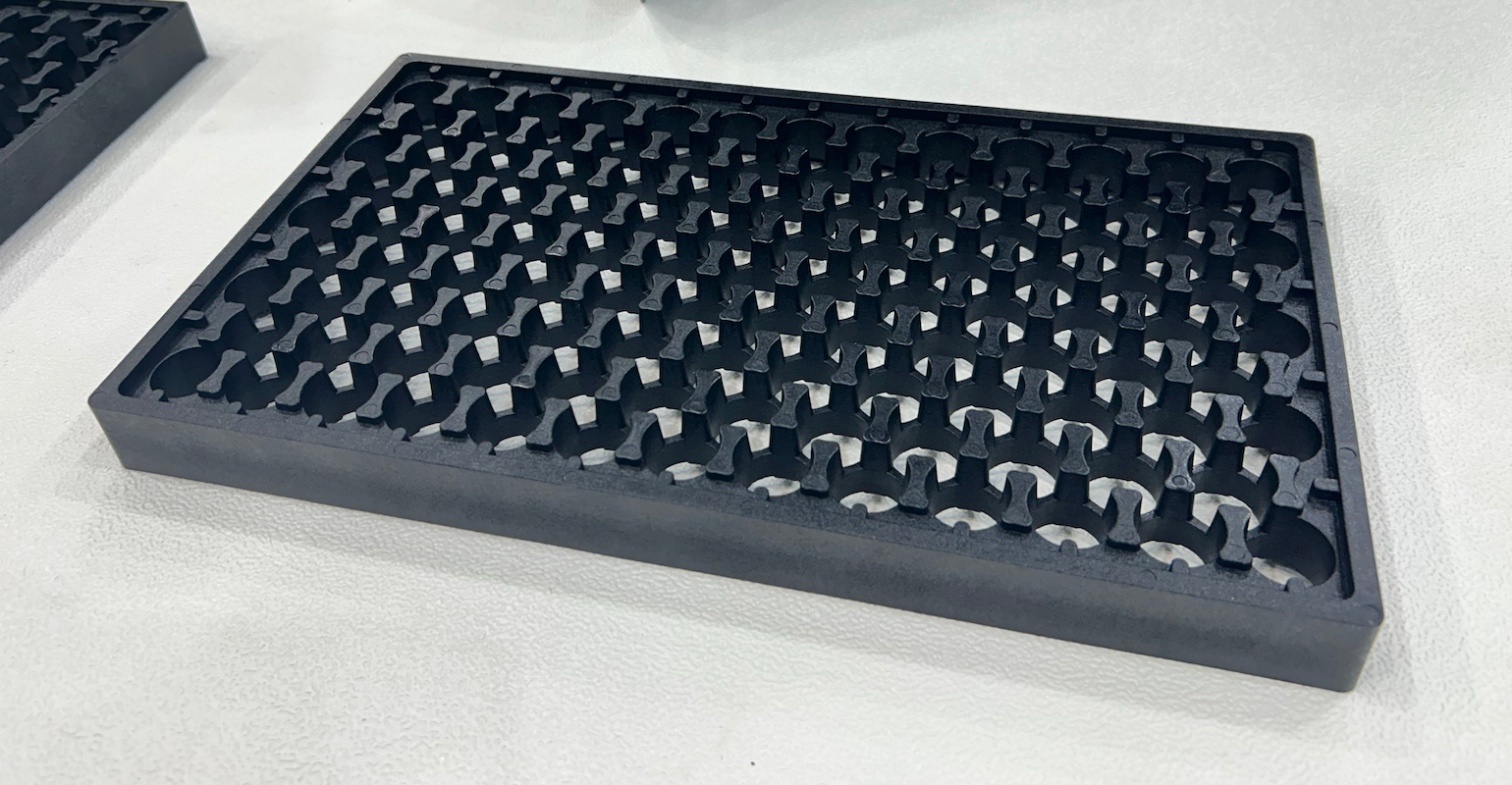

The recent Koplas Show in Seoul featured a number of injection molding innovations from machine builders, among them a low-pressure physical blowing process that demonstrated molding of an electric vehicle (EV) battery cell holder from a 40% glass-fiber-reinforced grade of polyamide (PA) 6. According to Joo In Chan, a staff member of the overseas sales team at Woojin PLAIMM, gas pressure as low as 70 bar (7 MPa) is sufficient when molding the 1,365-gram battery cell holder. It is 20% lighter than a non-blown equivalent component, while also exhibiting higher rigidity and no sink marks. “Competing processes can use pressures up to 200 bar,” said Jo.
The part was molded live on a DL500A5 (Super-Foam) machine with a clamping force of 500 tonnes in a cycle time of 210 seconds. Eight such EV battery cell holders are required for a single battery module.
