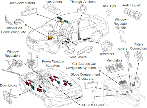

Polyacetal finds wide usage in many applications that potentially expose vehicle occupants to VOCs |
