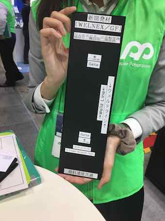

Welnex/GF delivers weldless injection-molded parts. |
As opposed to conventional talc-filled polypropylene (PP) grades employed in interior applications, weld lines are almost invisible with the new grade, which crystallizes relatively slowly like a random copolymer grade, resulting in better integration of the two flow fronts. According to a JPP spokesperson, while the cycle time might consequently be roughly 10% slower, advantages such as no need for coating and a softer feel despite the 10–30% glass fiber reinforcement content have already convinced some end user to adopt the material.
