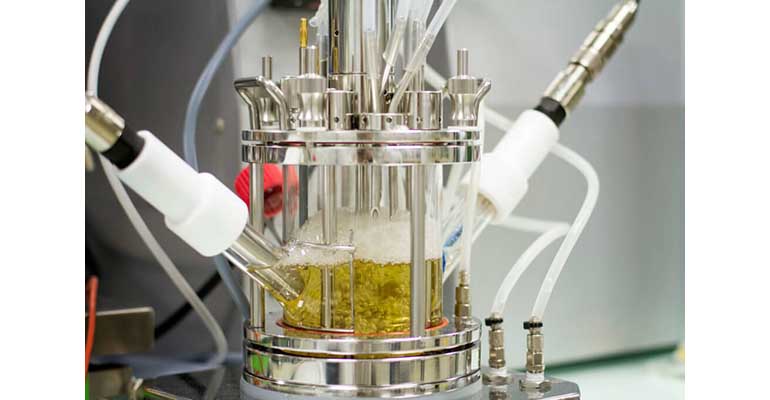

Carbios has been working since 2015 to develop a process that combines enzymes and plastics to transform polyester textile waste back into two purified monomers –– terephthalic acid (PTA) and monoethylene glycol (MEG). These constituents can then be repolymerized into PET that can be used to produce PET with virgin-like properties.
Carbios currently is operating at pilot scale, and counts the quantities it produces in cubic meters. But by September, the company says it will start a demonstration plant in Clermont-Ferrand, where it shares headquarters space with Michelin.

Carbios’ enzymatic recycling process uses an enzyme capable of depolymerizing the PET contained in various plastics or textiles, to include such things as bottles, trays, and polyester clothing, potentially enabling what it calls the “infinite recycling of all types of PET waste.”
