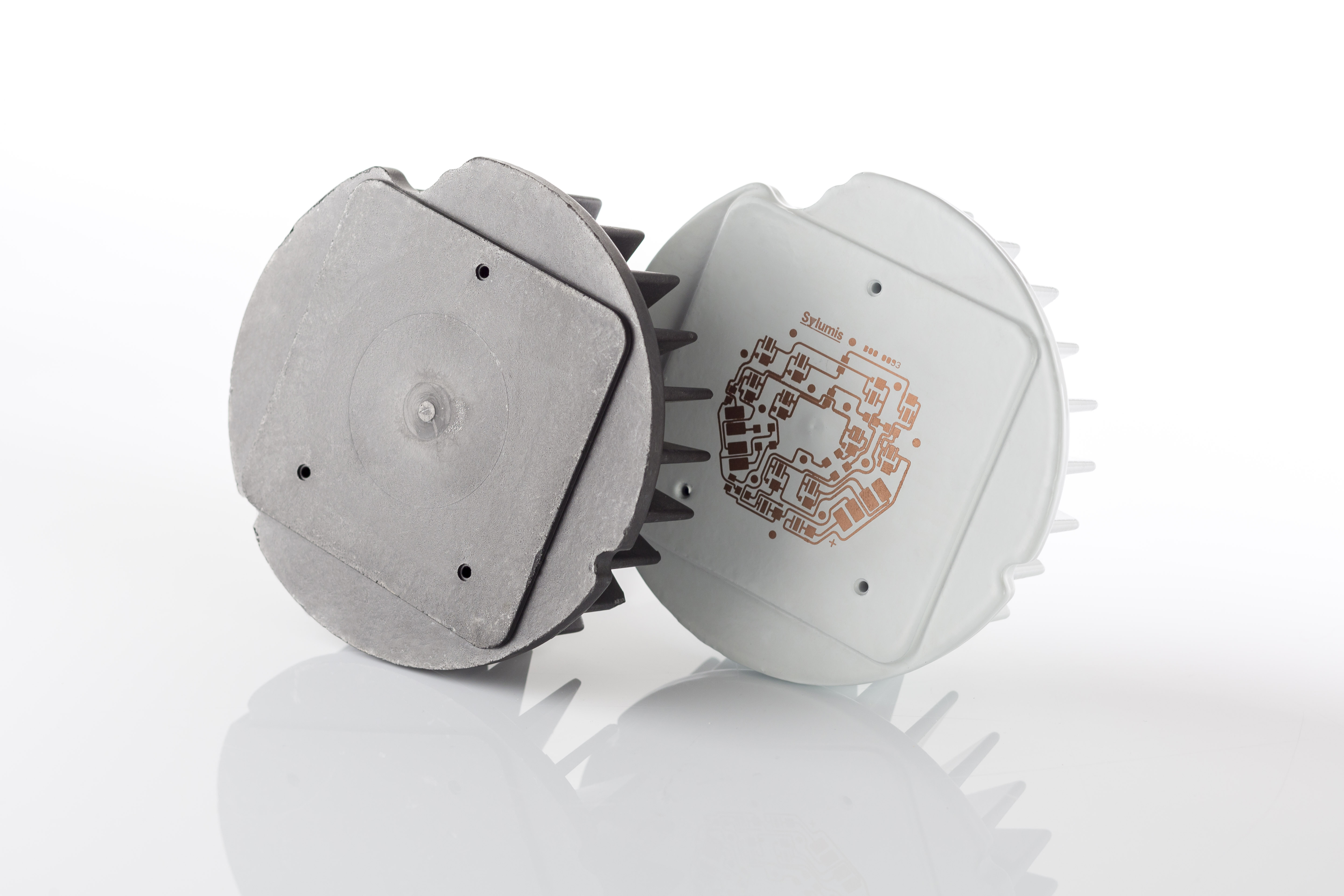

Since introducing the technology at the 2014 Fakuma trade show, PolyOne has worked steadily further in collaboration with a number of companies on the development of a new process for manufacturing LED functional heat sink printed circuit board assemblies. And at the VDI conference in Mannheim last week, the latest 3D MID light – “the 2.0 version”, as Jochen Kuntermann, Corporate Strategic Account Manager E&E-Automotive at PolyOne, called it – was prominently on display at the company’s booth.
Based on 3D molded interconnect device (MID) technology, the process makes use of PolyOne’s Therma-Tech thermal management compound, from which the plastic component is molded. Using Therma-Tech thermoplastic material, which, in addition to being thermally conductive can also be formulated for electro-conductivity, has the advantage, among other things, of eliminating the need for a metal heat sink, explained Kuntermann. It also enables a considerable weight reduction to be achieved.
How? Replacing a metal heat sink with one molded from PolyOne’s thermally conductive material enables a manufacturer to place electronic circuits and components directly on the three-dimensional plastic components. Conventional assemblies make use of metal heat sinks to transfer heat away from LEDs, coupled with a printed circuit board for mounted LEDs. Using 3D MID technology, printed circuit boards become a thing of the past: the conductive circuit is realized directly on the 3D molded body. This cuts out a number of manufacturing steps, resulting in lower production costs, and offers a far greater degree of design freedom than hitherto possible when designing LED lamps.
The process is relatively simple: the Therma-Tech molded body is coated with a non-stick laser-activatable black lacquer, after which a laser is used to cut out the required circuit track.  A plasma gun, loaded with copper metal powder, which melts into a liquid plasma stream, is used to treat the surface. The copper only adheres to the cut-out areas drawn by the laser, creating an electrical circuit, explained Kuntermann. The LEDs are then soldered on, using the lead-free reflow soldering process.
