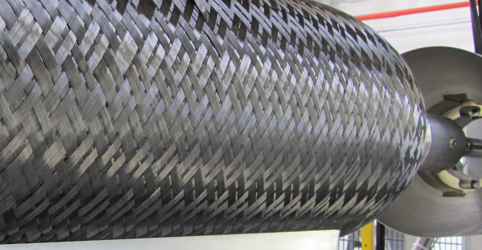

CFRP hydrogen tanks
Photo: BBG
German high pressure resin transfer molding (HP-RTM) toolmaker BBG has presented a concept for tooling that allows for the quick and reproducible manufacturing of compact, modular hydrogen tanks, which are made of carbon fiber-reinforced plastic (CFRP) and can be used in many vehicle types. The tank modules are made of carbon-fiber reinforced plastics (CFRP) and are molded in self-closing molds. The process does not require a press or further production equipment, such as autoclaves for curing.
To this end, cylindrical hollow metal bodies are overbraided with carbon fiber, and then a low-viscosity, resin-based mixture is injected under a high level of pressure in the heated mold. After curing in the mold, the modular CFRP cylinders can be removed and connected to form a tank.
Since tanks are made of individual CFRP cylinder modules, they can be tailored precisely to the installation space available in a vehicle. The modules can be integrated, for example, in the floor assembly to save space. Such a tank filled with 700 bar internal pressure facilitates a range that is similar to those offered by internal-combustion engines for hydrogen-powered passenger and commercial vehicles.
First the inner shells of the cylinders, which are also referred to as liners, are overbraided with carbon fiber. Then the blanks thus prepared are inserted into the two-part mold. Up to 15 cylinders with a diameter of 50 mm and more can be produced simultaneously per operation.
