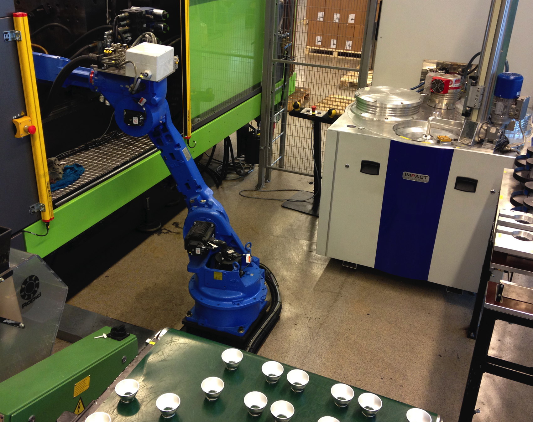

Production of metallized plastic reflectors at Norwegian manufacturer IV Group. PVD vacuum metallization is integrated with injection molding in a compact automated production cell.
Exhibiting partners Ehlebracht Plastics Technology (Enger, Germany), Impact Coatings AB (Linköping, Sweden) and pi4_robotics GmbH (Berlin, Germany) will operate the fully automated production cell for metallized plastic parts at the show in Hall A1/Booth 1205. The cell incorporates an Engel injection molding machine, PVD vacuum metallization equipment, robotic visual inspection and packaging of produced components.
The integrated solution reportedly boasts numerous advantages over operating injection molding and metallization as separate processes. These include lead-time reduction, improved quality, and reduced costs for non-value adding activities.
Impact Coatings furnishes compact and short cycle PVD metallization units suitable for lean integration. Production cells with injection molding and PVD are for example used for metallized plastic reflectors, helping manufactures reduce lead-times and costs, and drastically improve scrap rates.
