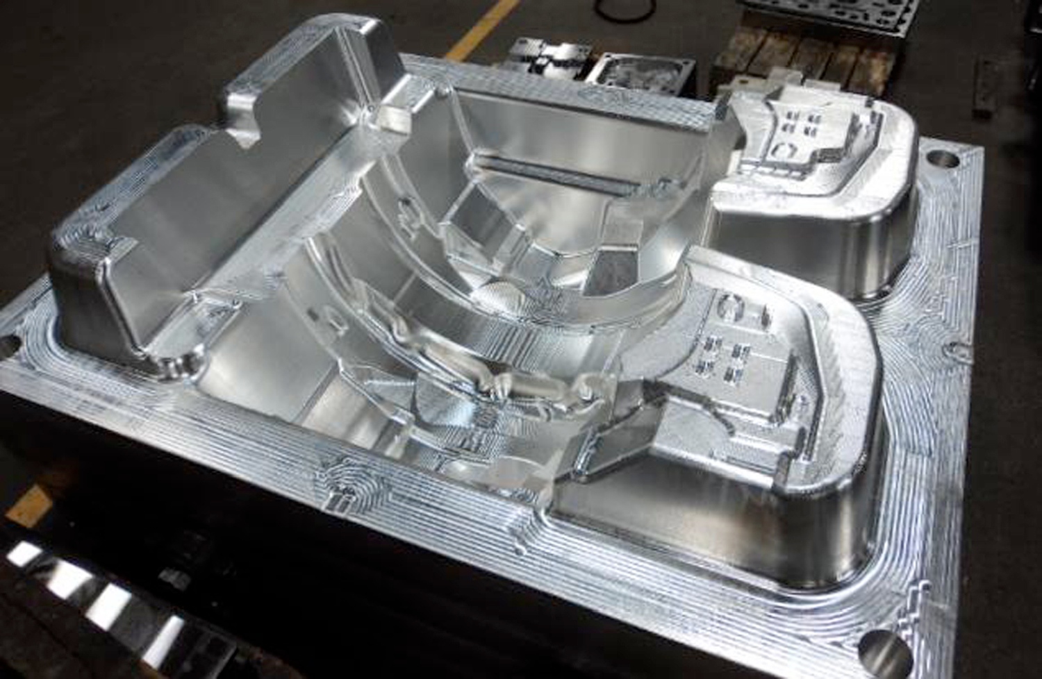

Mold manufacturers and OEMs like aluminum because it's much faster to machine, and faster to hand work. However, it requires all the same water lines and plumbing, like molds in steel. One advantage is that aluminum dissipates heat much faster, which molders like for cycle time.
While we typically think of aluminum molds used in large, single-cavity parts for injection molding or thermoforming, King explained that aluminum is "absolutely good" for smaller parts in multiple cavity tools as well. "We've done small parts, medium or large parts," he added. "Is there a sweet spot for the type of parts? The types of plastic used would be key. Materials such as polypropylene, thermoplastic olefins and polyethylene - all depending on the volumes - would be ideal. We can get about 1.2 million parts on a complex aluminum mold."

King provided an example to help us understand this point. Take a tool running 150,000 shots per year with a steel tool running a 50-second cycle. That tool would need to run 95 days per year, producing 1584 shots per day. That same part running in an aluminum tool at a 35-second cycle would achieve approximately 30% savings and require approximately 66 days per year of run time. This equates to approximately 638 hours saved. Hours saved means the molder would add press capacity without having to actually add presses!
