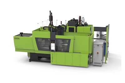

Engel is combining a victory 120 AMM with an insert 60V/45 vertical injection molding machine for the production of two-component housing demo parts at the K show. Picture: Engel

On the basis of its proven hydraulic and tie-bar-less victory range, Engel has developed a new injection molding machine for processing amorphous metals from Heraeus’ Amloy product range. The Engel victory AMM (amorphous metal molding) delivers fit-for-purpose parts with a premium quality surface finish within very short cycle times.
For the production of two-component housing demo parts at the K show, Engel is combining a victory 120 AMM with an insert 60V/45 vertical injection molding machine, which is equipped with a two-station rotary table. The manufacturing cell is fitted with both an Engel viper linear robot and an Engel easix articulated robot for the fully automated production process.
The first step involves injection-molding the basic structure for the housing on the victory AMM from a zirconium-based Amloy alloy. To do this, the viper robot takes an Amloy pre-material from the separator and transfers it to the injection unit. After less than 70 seconds, the metal component takes full shape. The viper removes the part and deposits it onto a tray. The easix articulated robot takes over from there, placing the Amloy component on the lower mold half on the insert machine’s rotary table, where a liquid silicone rubber (LSR) seal is molded over the part. The elastomer component also consistently fills out the seal structure on the bottom of the part through narrow openings on the surface of the housing.
