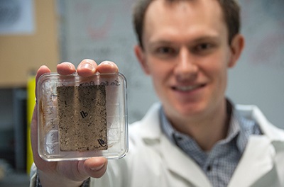

UBC researcher Bryn Crawford holds a sample sheet made with flax bio-waste. The black spots on the sheet indicate mold growth.

The research team examined flax and hemp fibers alongside other natural materials to determine what would happen over time to these fibers. They created ‘fiber sheets’ and then added fungi to some, water to others, and left another group of sheets untreated.
Crawford says they are not surprised that the materials grew mold; the idea of the project was to determine the types of environment where the fungal spores would grow and then test mechanical properties of the affected materials. The team conducted a variety of tests examining them for strength, stiffness, or the amount of energy that can be absorbed before the bio-composite materials failed. They also used scanning electron microscopy to take an extreme close-up of the interior of the sample to determine fungal growth patterns, examine fractures, and failure zones.
“It was a huge experiment and we found that in both the hemp and flax fibers, when no fungi were added, we still had fungi growing,” Crawford adds. “Basically, when raw natural fibers are exposed to high relative humidity, mold will grow and the potential for premature structural failure can occur.”
