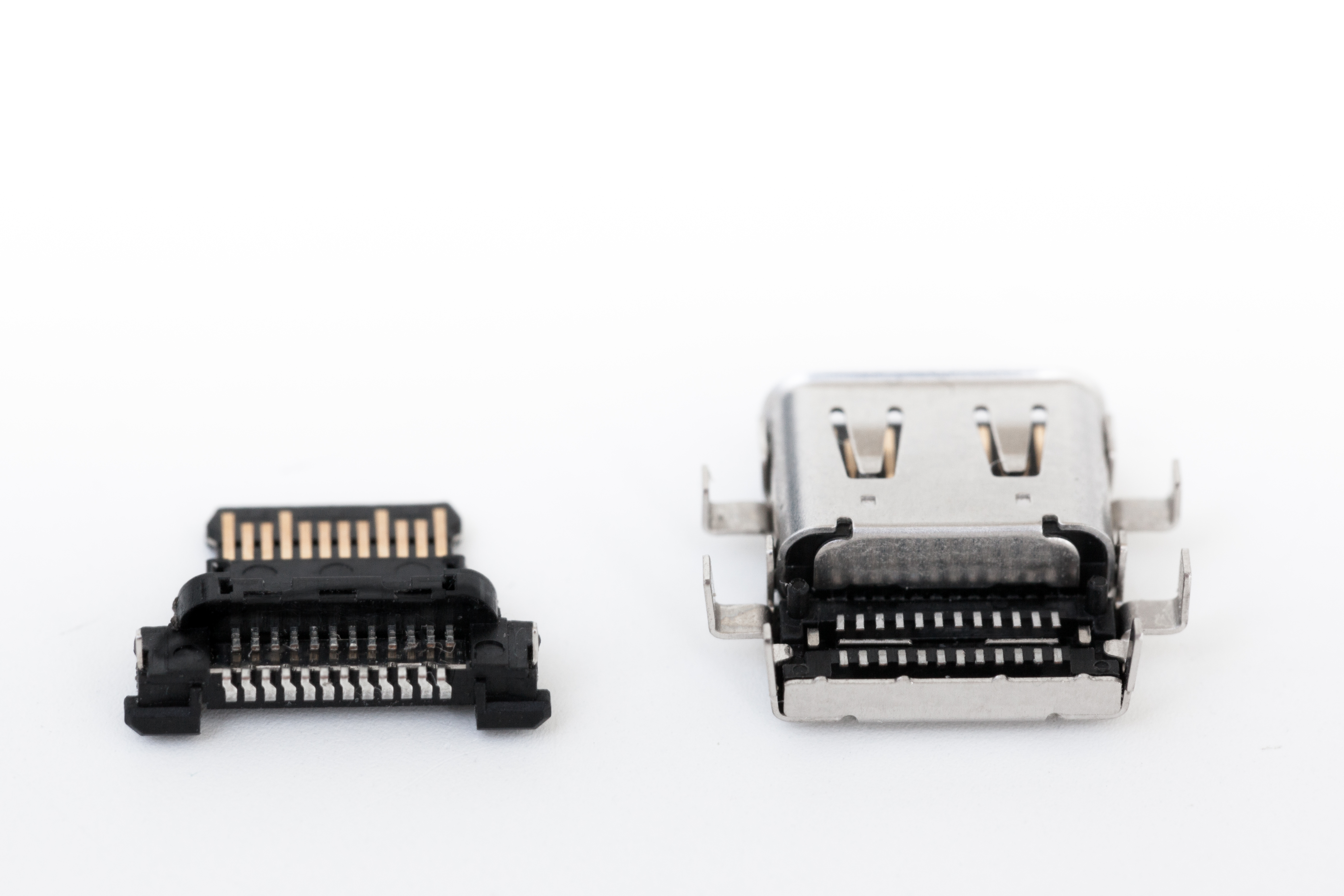

The first three grades in the family are ForTii Eco E11, ForTii Eco E61 and ForTii Eco LDS62. They can provide halogen-free solutions for parts with thinner walls, demonstrate very good flow and excellent mechanical and dielectrical properties. Key applications for ForTii Eco E11 and ForTii Eco E61 include surface-mount technology (SMT) connectors, such as the new USB-C, and also audio jacks; ForTii Eco LDS62 is well suited for use in RFID security casings, and the switches found in many portable electronic devices.
