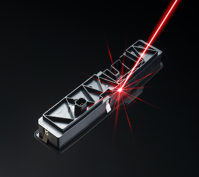

Laser transmission welding is a method employed for joining plastic parts. It enables even very small components with complex geometries to be produced in a cost-efficient and resource-friendly manner, making it part of the growing trend toward the miniaturization of electrical and electronic functions. This is why Lanxess has developed a wide range of laser-weldable polyamides and polybutylene terephthalates (PBT) Durethan LT and Pocan LT (Laser Transparency) and has recently expanded its range to include three new compounds. At K 2019, the High Performance Materials business unit showcased these compounds. “In addition to good, process-safe laser-weldability, the three new materials possess a range of other important properties that allow them to be used in a broader range of applications,” says Dr. Claudia Dähling, an expert in technical plastics at Lanxess. “Potential applications include components for electrified vehicle drives and driver assistance systems as well as devices for digitalizing the world in which we live: the Internet of Things.”
New compounds from Lanxess exhibit excellent laser weldability.
