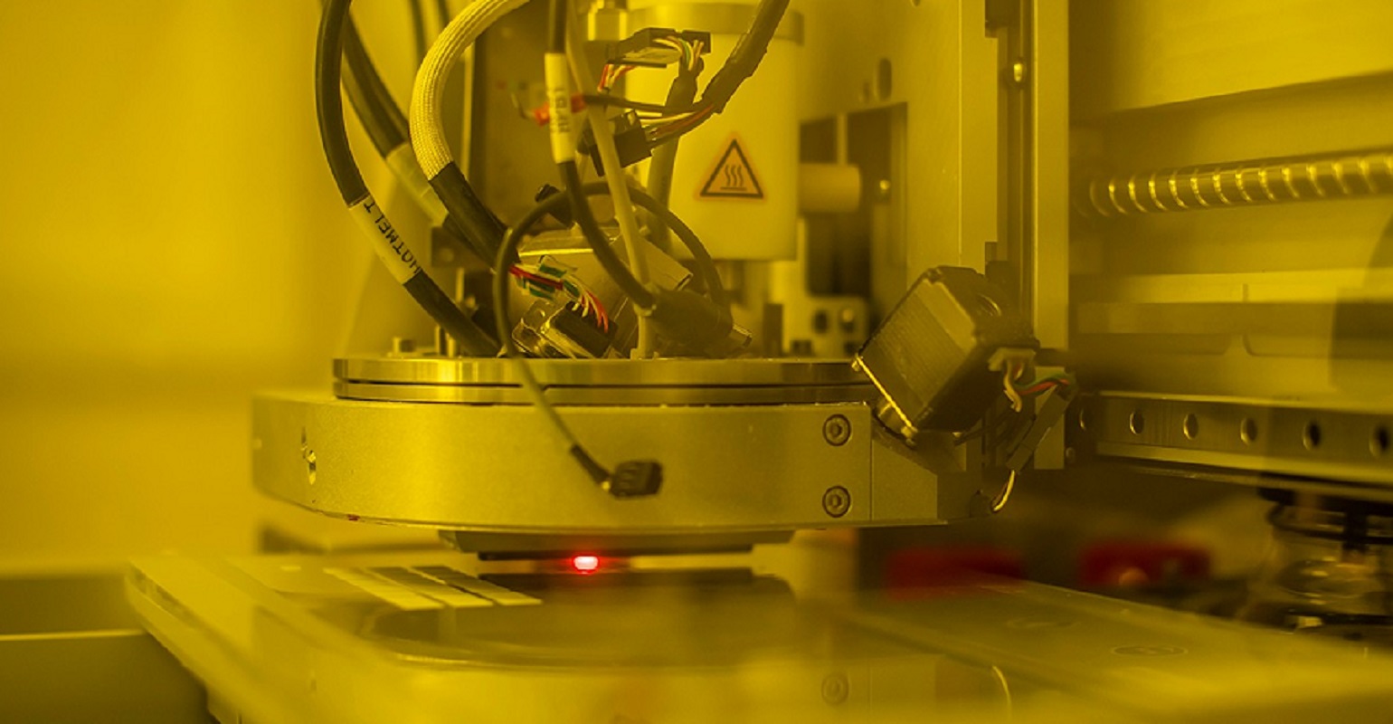

Using a new 3D printing technology, University of Nottingham researchers have discovered how to tailor-make artificial body parts and other medical devices with built-in functionality. The result is better shape and durability while cutting the risk of bacterial infection.
Researcher leader, Dr. Yinfeng He from the Centre for Additive Manufacturing, noted that “Most mass-produced medical devices fail to completely meet the unique and complex needs of their users. Similarly, single-material 3D printing methods have design limitations that cannot produce a bespoke device with multiple biological or mechanical functions.”

The researchers applied a computer algorithm to design and manufacture - pixel by pixel - 3D-printed objects made up of two polymer materials of differing stiffness that also prevent the build-up of bacterial biofilm. By optimizing the stiffness in this way, they successfully achieved customized parts that offer the required flexibility and strength.
Current artificial finger joint replacements use both silicone and metal parts that offer the wearer a standardized level of dexterity while still being rigid enough to implant into the bone. For this study, the team was able to 3D-print a finger joint offering these dual requirements in one device, while also being able to customize its shape, size, and strength to fit the individual patient.
With this added level of design control, the team was able to perform a new style of 3D printing with multi-materials that are intrinsically bacteria-resistant and bio-functional. This allows them to combat infection without the use of added antibiotic drugs.
The team also used a new high-resolution characterization technique (3D orbitSIMS) to 3D-map the chemistry of the print structures and to test the bonding between them throughout the part. This assured that the two materials were intermingling at their interfaces, a sign of good bonding which results in a device unlikely to break.
